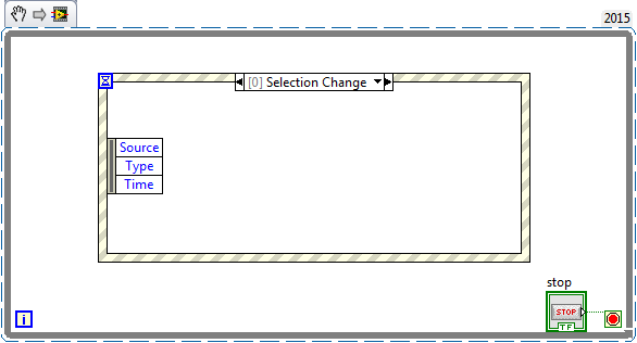

OK, has anyone ever seen this?

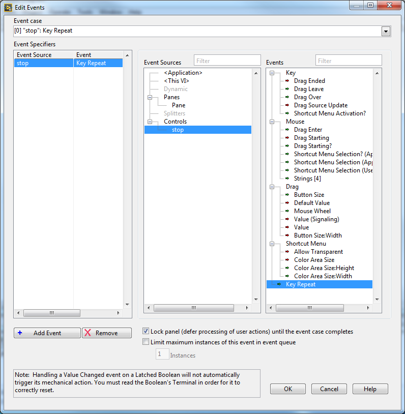

That's right the default "Event" case is now "Selection Change" and when I open the Event Editor
That's not right!
i've got a JING of the whole thing here
This is LabVIEW 2015 sp1f10.  And this just started today
Attempting to Edit an existing normal event structure pulls up the same "properties for events" list in the event case editor dialog.  Any suggestions?
If anypne knows where that lives on disc I'll just delete it and repair

Watch the Jing- I tried deleting LabVIEW.ini. But no
C:\Program Files (x86)\National Instruments\LabVIEW 2015\vi.lib\event_ctls.llb\lvevent type .ctl is right
How that enum isn't being applied to the Event Names scares me a bit.

A Complete Repair including the patches and a reboot got me back up and running.  Thanks guys.
