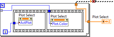

I get an error when I add an additional plot to a waveform graph.
This happens when I add another Active Plot to a waveform Graph or Chart after the first graph has been generated.
Removing a waveform does not cause the error. Not changing the number of plots does not cause an error.
I've done some sequence control to manage any racing that could be going on.
The error window comes up and if I select "Continue" the program runs with the added waveform present in the graph just the way I expect.
If I could just continue without the error stalling my program I would be happy. I'm wondering if a bug is causing this.
Any ideas?

I turned off automatic error handling in the program execution menu and it appears to be working correctly so don't bust a nut trying to figure it out.

Attach your vi with automatic debugging enabled.  There is a much better solution.
