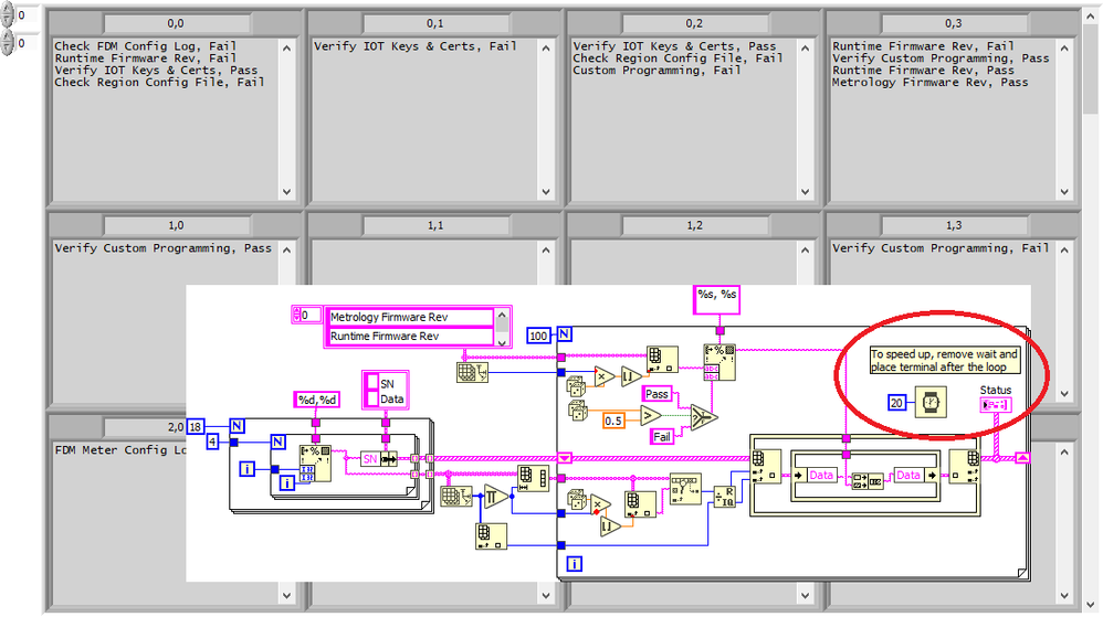

@itronChiraldude wrote:
Criticizing is pointless.
I am criticizing, because You do heavy operations on front panel objects instead of data in wires/memory. Involving the UI tread is an abomination. All the UI thread should do is asynchronously update the front panel from the transfer buffer when the data is written to the terminal.
I assume that the attached quick modification is what you are trying to do. I think it would be trivial to Put the 2D array of clusters into a DVR and operate on that using the DVR reference as one of the subVI connectors. Have an independent loop in the toplevel that occasionally reads the DVR and sends it to the terminal. (not shown)

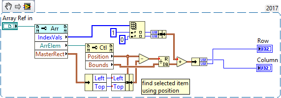

@Ben wrote:
The knowledge that the "element" property points at the active value may offer a cleaner approach when I am dealing with a GUI supported by an event registered against a 2D array for "Value Changed". Before that adventure yesterday, I would have most likely been doing a compare of the Old and New values to discover which element had changed. But knowing that the "element" property of the array points at the element that has the key focus, I may be able to implement the event more efficiently. This could be important if I am dealing with a large array.
So knowing more than one way to get home from work is not a bad thing.
Thanks for the adventure!
Ben
This is pretty much what I do.

My approach is not sub-optimal, it is completely unworkable.  My goal is to allow the user to use the scroll bar to view all array elements but any interaction by the user may change the key focus.
If the documentation had been clear about this, I never would have gone down that path!
