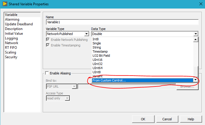

Do you know what a control type of file is in LabVIEW and typedef controls?  It is a custom control you save.  If not, take some tutorials.
What version of LabVIEW are you using?  If you look below variant, you can see you can select a custom control file.  When you pick that, you select the .ctl file you made from the control or indicator you made from the FFT wire.  I highly recommend saving that control as a Typedef.

I have no idea how you can know what a typedef is and not know how to create a .ctl file.  In order to have a typedef, it needs to be saved as a ctl.
Here:  Step by Step.
1.  Right click on the pink cluster.  Create Indicator.
2.  Right click on indicator.   Make Typedef.  (now you'll see it has a black triangle in corner)
3.  Right click on indiator.  Open Tyepdef.
4.  (Optional)  File >> control properties.  Give it some meaningful documentation.
5.  (Optional)  Double click the icon to edit it so it isn't some the generic control icon.
6.  File >> Save with a filename that is meaningful.
Now when you select the custom control in the dialog box, you can select the file saved in step 6.
