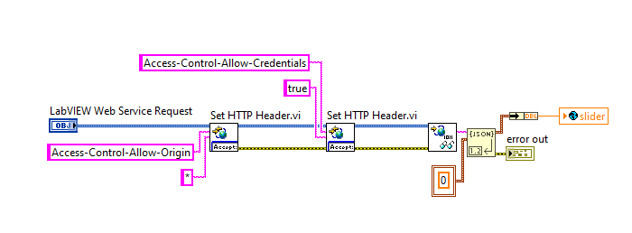

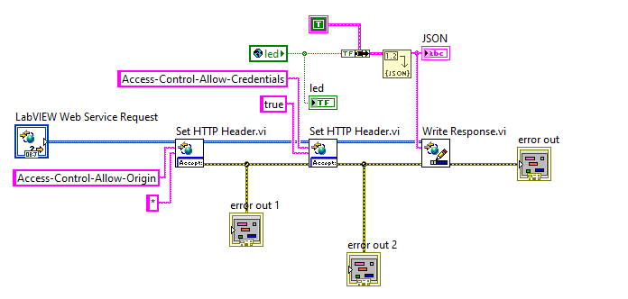

I configured a GET and a POST method with an added header to prevent this but it's still not working. Is there a mistake in my method VIs? Does anybody know what could be the issue? I am not that experienced in HTTP.
My GET-Method VI:
My POST-Method VI

I have the feeling it is because of the Post method. When i open the URL of Get and Post method in the browser, while in Debug mode, it opens these sites.
GET:
POST:
Message 2 of 8

Your GET and POST code looks fine for the web serivices.
