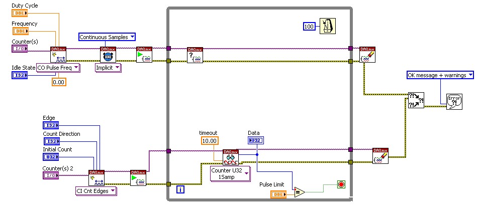

Hi sherard,
The reason you are receiving that error is due to the fact that you are specifying two channel types for one task.  You need to create separate tasks for the counter output (pulse generation) and for the counter input (count edges).  In the screenshot below, I have combined the two examples recommended above and added a pulse limit control to stop the generation at a set number of pulses (per your application).

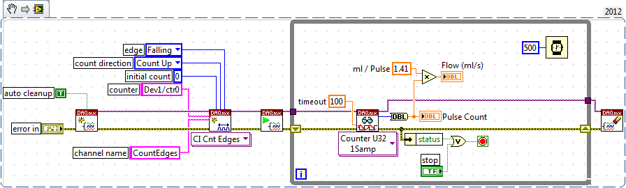

@HXdaq wrote:
can you help me write the labview code to count a pulse flowmeter
Attached is prototype code for counting edges, you can modify it to meet your requirement.

thanks Smiley Happy can you send me the VI because I can only see the URL on the block diagram
Message 7 of 13
(10,057 Views)
If you directly drag the attached PNG image, you'll find only URL in the block diagram.. However if you download the image and then drag it to the block diagram (from disk), you should be able to use the snippet.
Edited: you may also want to remove the scaling (multiplication with 1.41) Smiley Happy
