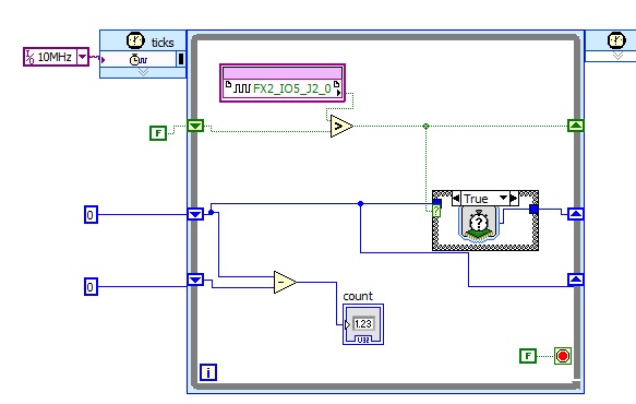

can one help to built a lv FPGA to measure the pulse duration
my first start lv VI is shown below for Spartan 3E kit the but its fail to work
is thei rany modify make it work??
for the case structure in false case the old value is moved instead of tick counter
best regards

Hey mangood,
Do you just want to count the number of ticks that a Digital line remains high and then output the result?
Ryan

@Ryan-P wrote:
Hey mangood,
Ryan
i want number of ticks that a Digital line remains high and number of ticks that a Digital line remains low
and can work for long time for more than 1 hour
02-24-2014 08:18 PM
Get rid of the boolean shift register and the timer function inside the loop. Just have two shift registers one for the high count, one for the low count. If the Digital Input is True, then increment the High shift register. If it is False, increment the Low shift register.
02-24-2014 08:43 PM
Like RavensFan mentioned, the simplest way is to use a pair of shift registers and record two of the following three: cycles high, cycles low, or total cycles. Increment the value that is currently active based on the I/O value.
What is the expected pulse/cycle rate of the signal? You mentioned reading for over an hour, do you need to have exact values for verifcatoin, a rolling average of pulse counts, a median value, etc. All of these can change how you store and process the results.

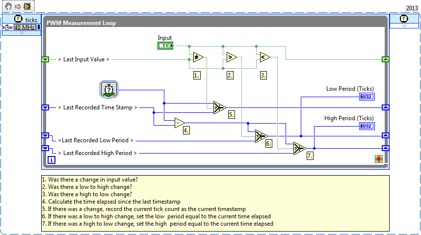

There is also an Example in the NI Example finder on exactly how to do this![]()
You can search for Pulse Measurement to find it, or use the snippet below:
02-26-2014 09:28 AM - edited 02-26-2014 09:52 AM
dear
thank you all for the replay
i will use the NI Example for test
i think the iniail problem of such VI is the timer wraps to zero. If this timer will work under 40MHZ source clock
how long is the timer will be work without wraping??
back again after test
