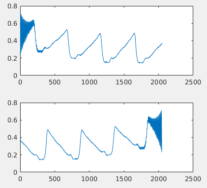

I realize that English is not your first language, however, data was posted and not your algorithm.   I have read your assignment and now see that your instructor's goal is to have you implement an algorithm in LABVIEW.  This is why I asked for the algorithm.  Use Google to search for Pulse oximeter Beer's Law.  Ask your instructor to help you with calculating the SAO2 and PULSE RATE by hand (no computer).
I have a few observations and suggestions to improve with your LONG-TERM learning (this will not help you with your assignment):
1) Labview = Data-Acquisition.   I suggest that you use measure an analog oximeter signal (http://tinyurl.com/oximeter1) to learn how Labview can be quickly used measure signals.  The video shows an Nellcor N600X analog pleth signal collected with MATLAB using an Arduine Due: the concept is the same.
2) MATLAB = Signal Analysis.   A mathematics package like MATLAB is the place to prototype the algorithm.  The upper plot shows your red data:
I think that because of the order in which the data is stored, the data is 'backwards': the MATLAB command fliplr() was used to create the lower graph which (from experience) depicts a more realistic pleth waveform.  I discarded the first data point and first column.    Although this is a NI board and NI has made significant progress in the last 20 years regarding signal processing, MATLAB or NumPY would be my first choice.
3) Finally, I would suggest that you focus on either the algorithm OR the data-acquisition: NOT both.  The algorithm involves Beer's law and it would be helpful (maybe necessary) to have an undergraduate EE degree.  If you are an undergraduate or in highschool I suggest using wiring a Nonin iPod 3150 oximeter to a PL2303HX Converter USB To RS232 TTL USB To COM to demonstrate that you can wire up a device correctly and read a signal.  I have mentored students serial communications and have 2 devices remaining that are 'plug and play.
