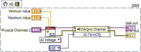

You can configure the analog input configuration by inserting a DAQmx Channel Property Node between "DAQmx Create Channel" and "DAQmx Timing."  Choose the property Analog Input -> General Properties -> Input Configuration -> Terminal Configuration.  Change the property to Write and create a constant set for the configuration you want.

Right click on the property node and click Change To -> Write.  You want to change the analog input configuration, so why did you put the property node on the digital output channel?
