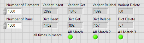

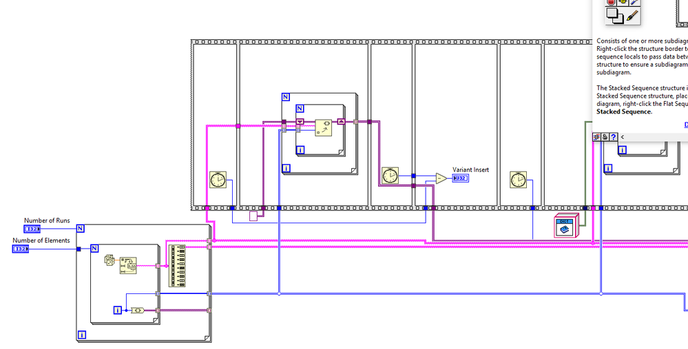

Your 1st timing includes the time to create the arrays, if you wire the created array through the 1st frame time will change considerably.
Also, it seems Variants as variant attributes are slow. If you set the Integers as data instead of the converted variant (fix the wire to the 1st frame) this is what happens:
The Relabel is much slower on the variant attribute, the other operations noticably faster!
/Y

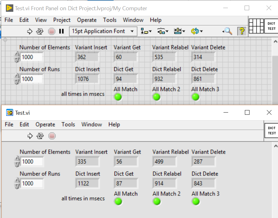

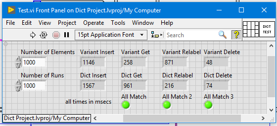

Just tested at home, better computer than the work one. Parallellized all loops (except the comparison ones since they couldn't be. Comparison between IDE and compiled result.
Variant hash, IDE on topVariant hash, IDE on top
/Y

Looking closer at the test code (both the original and the modified) I think there is a lot to improve....Building arrays of the variant (and dictionary references) for each run instead of operating on the same all through the run is a bit odd in my mind for example. The key names are not guaranteed to be unique either, I typically get half a percent collisions...(50 per 10 000 keys).The modified version introduces another variable - parallelism. I would say that adds  a somewhat irrelevant complexity (unless of course you would access it like that in the actual application), when what we really want with the repeated runs is to just average out noise in the numbers.
Rebuilding the test code to just repeat the whole train of operations instead on each run, and work on a single variant/dictionary ref, the results are more in line with the good results I got when using the hash map in a realistic scenario (based on storing doubles only) on a slower target (cRIO-9030).  I find the hash table to be 2x times faster than the Variant on writes on my PC, but 3 times faster on a cRIO-9030 (Linux RT). The inserts and reads are pretty much identical on the PC, but reads are 30% faster on the Linux RT target. The hash table is extremely sluggish when it comes to deletes though, as it is right now.
