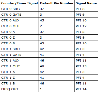

The following chart shows the default terminals for M Series devices and should help you out as far as connecting signals goes:
Using default terminals, B should be wired to PFI 10 for the AUX line (you may also select p0.6 if necessary but this is not the default).
One other thing to point out... instead of an Edge Count task with an external direction control I would use an Encoder Task (the connections should be the same: A goes to PFI 8 and B goes to PFI 10 for counter 0).  The Encoder Task will allow you to use the Z index among other things.  The Measure Angular Position.vi shipping example is a good starting point and can be found at:

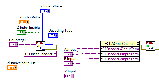

If desired you may change the PFI lines to be used with a DAQmx Channel Property node, it would look something like this:
The VI is set up so that the configuration of your DAQ device takes place once (before the loop).  Then, counter is polled continuously inside the loop.  The task is then cleared after the loop.
