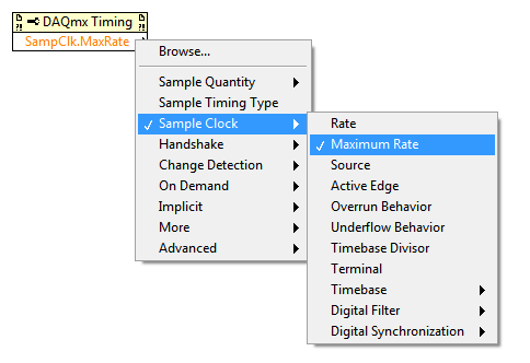

Hi Brian,
We do have a DAQmx Timing Property that will return the maximum sample rate for your task:
From what it sounds like, this is what you are looking for.  Let me know if you have any questions!

You can use a DAQmx Device property and select I/O Type>Analog Input>Timing and Maximum Single Channel Rate and Maximum Multiple Channel Rate

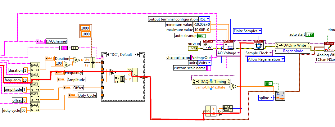

Here's what I came up with. It seems to work well when I send it to a USB-6259, but the property node barfs when I try to send it to a USB-6008 analog output channel.
Attached is the VI saved in Labview 8.0 format.

I'm not aware of that technical term 'barf'.
Since the 6008 has no sample clock for analog output, you might want to first read the 'Sample clock supported' property.

I also notice that the Sample Clock setting comes from elsewhere in the program (see below).  It should match with the rate that you are resampling your waveform to be genreated (you can just feed in the Max Rate property to the DAQmx Timing vi).
Best Regards,
John Passiak
