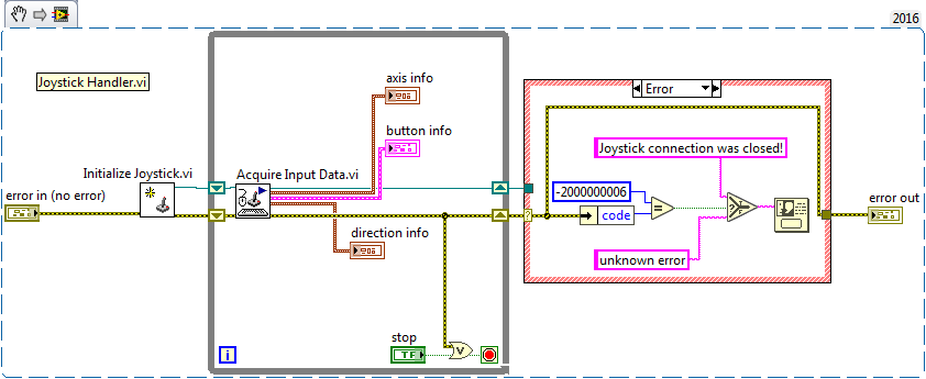

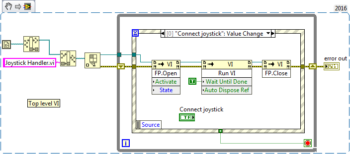

My workaround is to initialize and use the joystick connection in a sub vi which is called dynamically:
After disconnecting the controller error -2000000006 appears and the "Joystick Handler.vi" closes.
Then you have to call it again dynamically like I did in my "Top level.vi" above.
This worked fine for me.

Interesting. But the part I actually want to get around is that in your example, the user has to trigger the reconnection by clicking the button.
I would like to have a way of constantly checking in the background wether the controller is connected or not and then read it or not.
