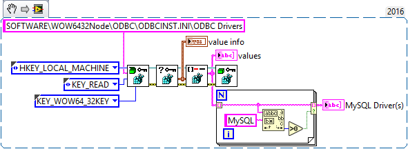

I did this once but i have only tried it on my computer, don't know if it works for others.
I have windows 10.
/Peter

Thanks Peter, that's fantastic.
The big clue was
WOW6432Node
i.e. access 32bit registry on 64 bit machine.  I had read value too which for some reason didn't work (-603 error).  Your solution works perfect!

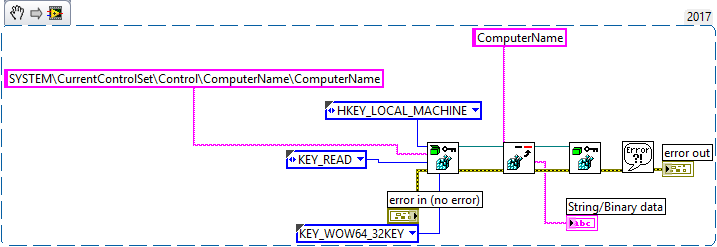

P.S. In case anyone interested, the below will read the computer name (note the intentional omission of 'WOW6432Node' in the subkey constant - it gives a 603 error if it is left in).  I was confused!
