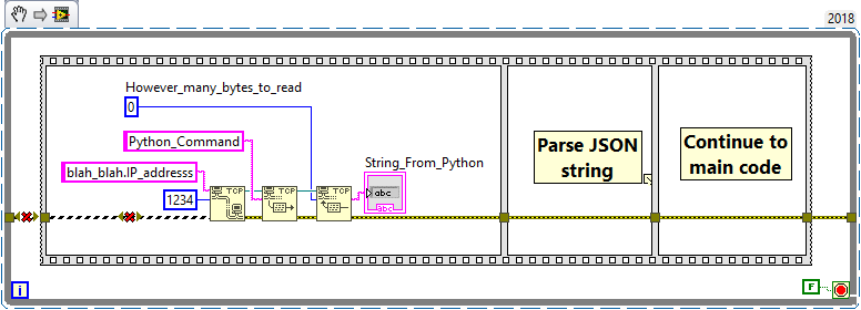

I am currently using a TCP/IP connection to connect my cRIO-9035 to a Python script on my host computer. Currently I am sending a large JSON string every iteration of my Real-Time loop similar to this users original loop. I'm not sure if this is good practice considering that the string being sent over isn't changing every loop.
The string being sent over changes only when the users presses a button on the Tkinter GUI via the Python side. It looks something like this:

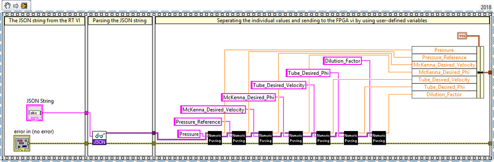

Where the Python command and bytes to read are using a subVI created from this example and I parse the JSON script in another SubVI here:ParsingSnippet.png

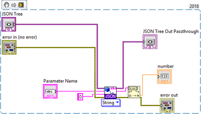

Where "Numeric Parsing" is a simple vi that parses out a double from the JSON String object:NumericParsingSnippet.png

I'm curious, is that sequence structure just for documentation?  (It is actually influencing dataflow in a subtle way - the JSON string control is forced to be read from before the constants a few frames to the right, instead of letting LabVIEW decide what is most efficient at the time of execution.)  If so, I usually just use a flat frame decoration with free labels:
Admittedly, they're a little more tedious to use than a sequence structure - the wires want to avoid the frames - but it doesn't influence dataflow.
Oh, and that icon-o-sized cluster should probably be a typedef.  That way you don't have to recreate it everywhere you use it, and if you add or subtract a control, all the copies get updated.
Bill

@billko wrote:
I'm curious, is that sequence structure just for documentation?  (I don't see it influencing dataflow in any way.)  If so, I usually just use a flat frame decoration with free labels:
I used it for documenting purposes only.  I tend to frequently and accidentally move around the free labels around so the sequence adds a bit of structure to it
I don't usually use sequences, but it was easier for me to ask questions this way

@atokad wrote:
Nice - see why now.  It was pretty simple to break it up for us to see when you are asking questions.
