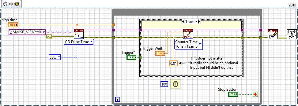

Neither, the USB 6221 has a counter.  Use it instead.
