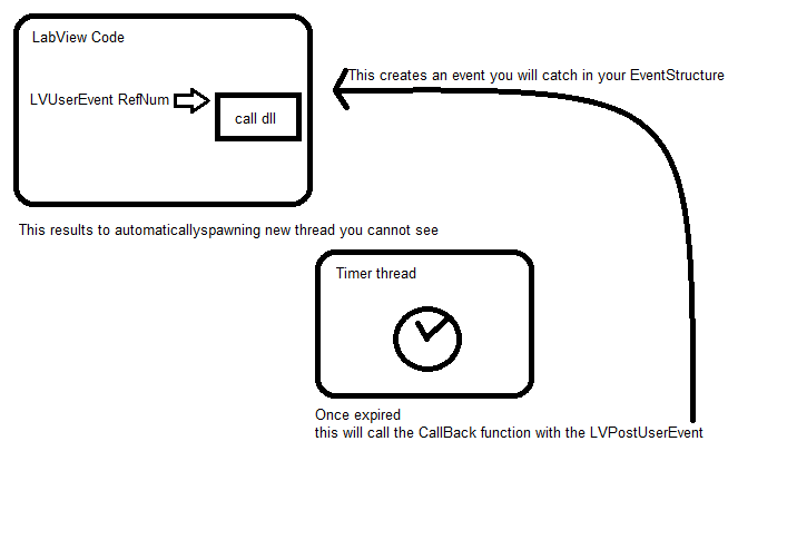

Dear fkczd,
to use that function, you need to create the callback function in your MS Visual studio project.
I guess you need something like this:
1. Create a calback function (normal function) that uses LVPostEvent, you need to include extcode.h in your DLL project, this is the same as if you used the LabView function Generate user event.
2. Create a variable that will hold the pointer to this function.
3. call the timeSetEvent with the fuEvent parameter = TIME_CALLBACK_FUNCTION, in user parameters, you need to supply the LabView Event RefNum (create labview event and pass refnum to the dll Call)
This should result in geting the event if the timer expires. You need to register the user event you use in the LabView event structure.
Message 7 of 30

    Thank you Bublina for illustrated explanation.
    I can understand the concept,but how to do ? LVPostEvent is not open for user, I have no idea about how “call the timeSetEvent”. Do other languages,such VB VC, to achieve callback functional in winmm.dll,LabVIEW CAN NOT to do?
    I guess,there my be some tricks in LabVIEW which I have not found,or LabVIEW can achieve this aim (read dafa from some instruments with fixed period which uninfluenced  by other events,such as mouse click,keyup,keydown) with its special method or structure.
