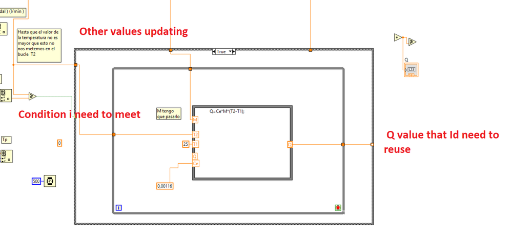

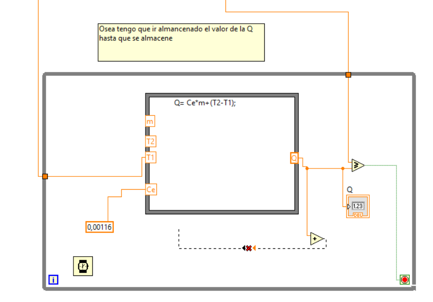

Thanks for your answer. May i ask you a really easy question, if I have a module that need to carry out an equation as you see, the problem is , if the value i get doesnt meet the condition i need to carry out the equation again but starting the Q from the new value. So I am not sure how to keep the value I get from the Q and keep reusing it until i get the result of the loop and i finish this loop. So i would need the value to update and keep reusing it... any idea please ?

Use a Shift Register.

I am so sorry for asking you again but it is a question related to your previous answer, you told me to use a shift,
but let me explain my current situation to you. I have one equation block and in order to enter to that equation block i need to meet a condition so I added a true/false structure, so I need the value of the Q that I get in a previous iteration of the equation I need to reuse it again until the result of the equation meets a condition. Therefore, I would need to enter in true/ case a shift that (I am not allowed to do that ) and I would need to enter the update value of the sensors for the new iteration.  So basically its a equation that is running , an for each iteration i need the previous value i got plus the new values i got from the sensors , as long as these new values meet the condition.

You seem to have a complete mess in your data flow.  So I recommend you completely rearchitect what you have into a State Machine.  But before you write ANY more code, WRITE down the exact process you need your data and application need to do.  You will notice the states develop.  Then you can program the State Machine pretty easily.

sorry but how can i programme that ? I think you havent answered to my question you just say i need to tidy everything, I completly agree.  But Could you please tell me  how I can manage to introduce the result of the equation and the new iteration of the values from the sensors again in a true case. Is there any way of keeping the result in avariable like normal programming and use it from that point ? I have been looking for that but I only get information about shift register that i think i cant use it here...

Hi jalatruken,
Learn about DATAFLOW: "variables" are wires in LabVIEW. Use shift registers to store data for next iteration.
