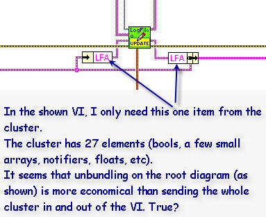

I have been wondering lately, as I clean up some code, how much it matters where clusters are unbudled and bundled. Please refer to these two pictures, and, if you could, provide your opinion. Thanks!
Diagram 1
Diagram 2

I'm not sure about the first question though if it is a large cluster I think the first may be more efficient. This is only my opinion though. The compiler may be smart enough to optimize that for you.
As for the second question, from a purest point of view you should only pass the data that the VI actually needs. Again, if this is a large cluster you may get extra memory alocations and use much more memory than you actually need. From the viewpoint of "future" proofing your code it may make sense to pass the whole cluster if you think it would be possible you would need to use more elements of the cluster in the future.

Agree with Mark on the first question, although it is purely speculative.  At least in the first case it is obvious that you won't be modifying the cluster.  No guarantees that the compiler will track things down inside the Case structure.    Unless it is a monster cluster, I would probably let aesthetics win, and that is a function of how many elements you will be using inside the Case.
The lower diagram seems to be asking for an In Place Element Structure.
Yes, it's perfect for that. Ok then, inside or outside the VI? It just seems to me that putting a big control and indicator in the VI is such a waste of.... buttons and whatnot. Smiley Tongue
But all this unbundling from a state machine data cluster gets large (in graphical size). Ideally, I'd like to know where the cut-off point is between esthetics and performance, and I'd like to know how some other programmers feel. I remember one time, one of the heavy hitters said that he had stopped being overly concerned with tiny minutiae performance aspects and was building his diagrams to be elegant and maintainable over and above saving an immeasurable amount of speed and memory. Do my two examples fall into the tiny minutiae category?
With LV10 and onward, you can have your cake and eat it too.  Put the IPE inside the SubVI, and set the SubVI to inline automatically and you get the beauty of the subVI and the performance of dumping it all on the BD.
I agree about the minutae, you are usually better off in the long run keeping your code intuitive.  As long as your intuition is reasonable, you are fine, and you can wait for an actual performance issue before diving into crazy tweaks that may make a slight difference.  Most of these tweaks are becoming outdated anyway.  It seems to me that the tide is turning: for a long time we had to do things to improve the compiler's performance, now the compiler is beginning to do things to improve our codes' performance...

About diagram 2. The way it's coded is more reuse friendly than to pass the big cluster to the VI.
