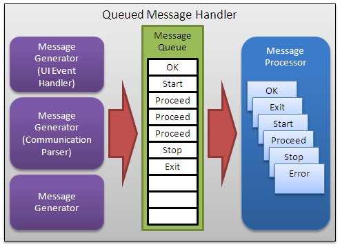

I've been reading up a bit on design patterns that seem popular among LabVIEW users, and I have a question with regards to the design pattern described in the following article:
http://expressionflow.com/2007/10/01/labview-queued-state-machine-architecture/
I don't see how this is a state machine at all. To me it just looks like a producer/consumer pattern for queuing up actions (what is described in the article as states) to be executed in the consumer loop. I don't see where a state machine comes into play, determining state transitions based on current state and inputs, like shown in the following:
https://www.ni.com/en/support/documentation/supplemental/16/simple-state-machine-template-documentat...
Am I completely off?
(3,418 Views)
That Design Pattern is really a Queued Message Handler.
Visualize the Solution
CLA
LabVIEW, LabVIEW FPGA
(3,408 Views)
Yeah exactly.
I was thinking a nice way to implement something QSM-like would be to produce instances of a message handler object that maintains its own state and a message queue. You could produce a new object for network I/O that inherits from the general message handler, one for managing the UI, data aquisition etc. They would communicate in a network by passing messages back and forth to their respective queues and each would be a true implementation of a state machine.
