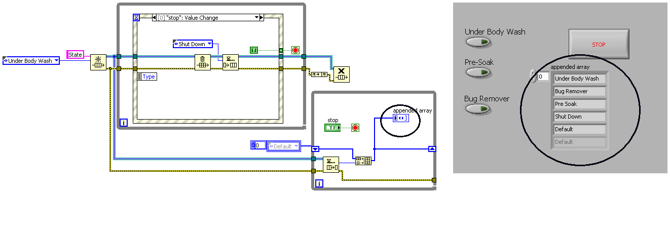

I am trying to build a VI where the user enables some boolean controls on the front panel.
The VI uses a producer consumer architecture wherein based on the booleans clicked,
certain states get queued an saved into an array.
After the user is done selecting, the booleans should get disabled and the array of states
should be indexed one after the other.
This is an attempt to solve the car wash sample exam.
However, the VI is not generating the required results.
Can someone please help me figure out what is the correct way to implement this.

Its because you have wired the consumer while loop stop from the first one. Remove that and in your consumer loop, do a compare of the states that you receive and if it equals shutdown, stop the consumer loop.

Your data flow was wrong to the second loop for the parallel process...Just wire your stop control directly to your second loopQueued%20SM[1]_BD.png

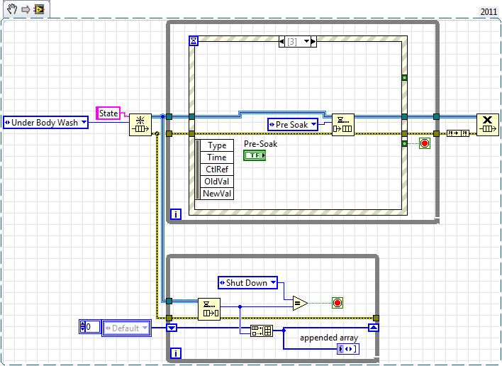

Now, I have extended this VI to attempt the Car wash CLD problem in a simplified form (without pausing in between states).
However, again I am finding that the array is not building up with the selected states.
What I am attempting to do is build the array based on the user inputs, then once start is pressed, disable the options
and start indexing through the arrayed states with a 5s timer in each state.
Can you please help me figure out how to get it to work ?

@SysArch wrote:
...However, again I am finding that the array is not building up with the selected states.

Please see the Queued SM_Sprinkler which is the new VI that I have attached in the previous post.
Message 7 of 19
(5,367 Views)
Its because your consumer loop is being shutdown when the first time the consumer loop executes, your equal compare will be true and it will stop the consumer while loop. Use single stepping and debugging features available in labview to see whats happening in your vi.

I have tried to debug it but am stuck at one stage..
I am not able to get the timer to count up continuously. The states get queued alright, but the timer just counts to some randome time
and then the code seems to halt.
Can anyone please help me debug ?
