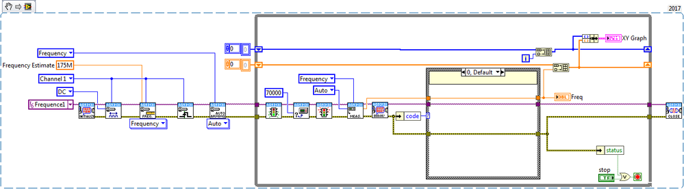

Im sorry my first post was a bit inacurate, So im trying to mesure a 0-24V square signal from an optic captor. My signal when my motor run is 170-250Hz. I just put an example of my programme, and I forgot to set the estimate frequence.
Same for the results.
Actualy you're right, when my motor stop and the frequence go down to 0 Hz, some time I get the -230 error and it shut down my GPIB connection. Anyway, Im trying to avoid that too.
But most of the time when I have 0 Hz it show some random values like 20M Hz or something that big.

So all you really need to do then is trap that error case, and deal with the out of range numbers some how.  You can do this in code or maybe by using the instruments frequency filters. (You'll have to ready up and experiment with that, I haven't used them except for stats purposes.)
Anyway, here's a modified version of what you posted with an error query and way to deal with out of bound measurements. You should modify as you require since I don't really know what you want to do with data when it throws the -230 error.
Hope this helps.
Craig
