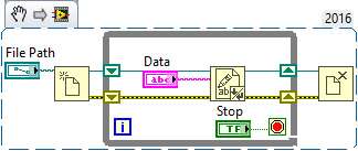

The snippet below shows the logic of the code you posted, which I called "Write One Line".  If you followed my suggestion to look at the Help for Write to Text File, you would have seen the following:  "If you wire a path, the function opens or creates the file before writing to it and replaces any previous file contents".Write One Line.png
This is exactly what you are seeing, so the function is behaving "as advertised".  However, it goes on to say "If you wire a file refnum to the file input, writing begins at the current file position".  This is the behavior that you want.  So try this model instead (which I call "Write Many Lines":
You open the file once, before the While loop where you generate "many lines" and write each one, one at a time, to the Text File, closing the file when you exit the loop.  Give that a try (and next time, try to figure things out yourself by carefully reading the Help documents, looking at the Examples suggested at the end of the Help document, etc.).
