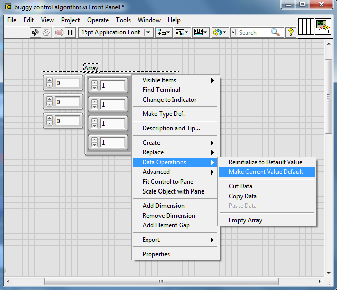

To make your data in controls persistent, right-click on control:
Then save your VI. You can also do this with your entire front panel objects from under the Edit menu.

Hey Bill,
   Thanks for the reply - I did try doing the same exact thing and saved it, but it didn't work.
   I will try again, but for now I left it as a constant.
   Thanks!
    TheLT
Message 6 of 15
(4,335 Views)
Bill,
   Ok, weird, but I think it work - updated code attached!
   So, my last problem is, am I doing the transforms right? ABC -> BAC, ABC -> CAB, and ABC->BCA? I'm sure I got the first one - the last two, meh.
