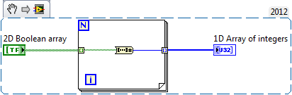

Hi
I have 2D boolean array, and I need to convert each row individually to a numeric 1D array like this
0:0:0 ----> 0
1:0:0 ----> 1
0:1:0 ----> 2
1:1:1----> 7
8x3 array to 8x1
I tried by Boolean Array To Number function, but it doesn't work because of the difference in the array dimensions, how can I do that?
Thank you
Message 6 of 10
(5,847 Views)
Convert each row of the 2D array to an integer using Boolean Array to Number inside an auto-indexing For Loop.
CLA
Message 7 of 10
(5,839 Views)
Hi ysma,
"oh all those wonders of AUTOINDEXING"
Message 8 of 10
(5,838 Views)
Thank you very much both of you....Heart
