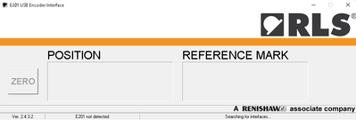

I have an E2019Q USB ENCODER INTERFACE but i couldn't make the windows recognize it.
I tried on win 10 & 11 and also tried compatibility mode for 8 and 7.
I cannot see it on NI-MAX as well as a COM Port.
I installed below drivers and software...
When I run the software I have the below screen.

I installed the drivers from ST microelectronics.
STM32 Virtual COM Port Driver...it works for E2019Q USB ENCODER INTERFACE
As I mentioned in the post if I install drivers from the RLS website from their documentation it doesn't work.
Now, all is good, and I can see it in NI Max and use it in labview.
