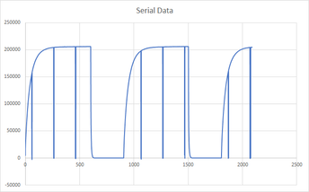

I am trying to collect data from an oxygen sensor that sends data through RS-232.  My computer is connected to the sensor using a USB-to-RS232 cable, and I am using the attached subVI.  The VI sampling period and sensor sampling period are the same at 200 ms.  However, at times I receive a glitch of some sort that makes the incoming data drop to 0, seen in the plot below.  I probed the "bytes from port" and I notice that it is consistently 11 and it varies wildly (from 7 to 13) at the same time that the data drops to 0. How can I programmatically ensure this doesn't happen?
