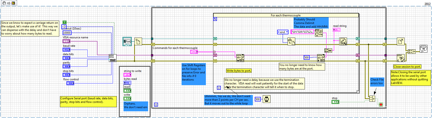

The serial port I am working with (Thermocouple Input Module) has 4 different channels to connect for 4 different thermocouples. It doesn't have the ability to acquire in all the 4 channels at once by writing a single string. So, in order to acquire from different channels I needed to write to the port everytime specifying from which channel I want the data to be read. I was thinking on the lines of round robin format such that after first string (corresponds to ch 1) is read it will wait for the time specified in 'delay before read' and then it will read the second string (corresponds to ch 2) and so on. The closest structure I found to use this in labview was Programming->Comparison->Select. But it can select only two depending on either True/False.
Is there a better way to accomplish what I'm trying to do here? I have also attached the VI I work with in case of reference.

Put your reads and writes into a For Loop.  Put the commands for each channel into an array and let the For Loop auto -index on that.  The it will run 4 times, once for each command in the array.  You can let the results autoindex as well which will automatically build them into an array at the For loop boundary.

I think Raven is thinking of something like this.  I also optimized the read since you know there is a term char.

Pretty nice work for a minion!  A few edits to improve some performance gaps and away you go.

Oh, oops - I guess I missed the requirement about the rate of aquisistion.
Also - really?  Did I miss those shift registers on the for loop?  Shame on me.
Good one about the file errors.  They are one of the most important errors to catch and I forgot all about them.
