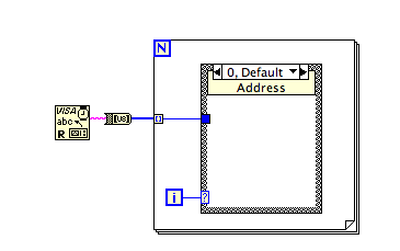

You could use 9 comparisons but autoindexing would be much more efficient. Convert the string to an array of U8 using the String to Byte Array primitive, then wire the array to the for loop.
Lynn

From here the output of the for loop should then be convereted to a string to be written to the TX?
