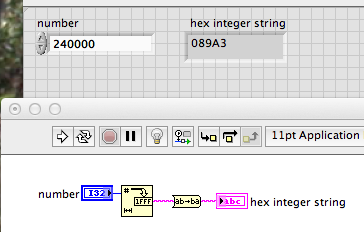

Sorry for bothering yet again,
I am trying to send my position number, but when I am printing out the hexadecimal string through an indicator I am not getting the value that I want in the correct order.
FOr example, if I try to print out 240,000 in hex I end up getting 00003A980 when I really want 80A90300.
The same goes for when I want to print out -240,000 in hex, I end up getting 0FFFFFFFFFFFC5680 when all I want is just 8056FCFF
In my attachment I have the image of the code I'm trying to currently fix.

There may be other ways.  But this one should work

May I ask what are those tube looking things that are covering the reverse string block?I can't seem to find it in the string palette.
Message 15 of 19
(1,809 Views)
Typecast.
It is on the Numeric >> Data Manipulation palette.
The picture is a snippet.  You can drag and drop it on a block diagram to get the actual code to poke around with.

Thank you I seem to have got it, my only problem now is that when I type in any number except 0 I end up displaying a 14 byte hex number. But if it is 0 then it will just display 00000000.
What I mean is that if I type in the value 1, I will end up printing out 10000000000000
Message 17 of 19
(1,796 Views)
Post your code so we can see what you are doing.
You aren't showing a 14 byte hex number, you are showing a 14 character hex number.  which is only 7 bytes.
It seems like you are using the wrong representation.  You should be using an I32 which is only 4 bytes, thus 8 characters in a hex formatted number that is fully padded with zeroes.

Nevermind I just saw my problem-- turns out I was using a signed 64-bit number instead of a signed 32-bit number, doh!
Thanks for the help everybody! I'll be sure to post if I have more questions.
