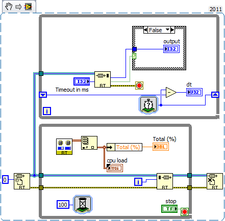

I'm trying to replace some queues with RT FIFOs on a cRIO9074 target (using LV2011), which should be rather easy as the API is very similar for both:
This example VI works for sure: the lower loop puts an I32 into the FIFO each 100ms, the upper loop should wait for "timeout" (set to 50ms) before attempting to read a new element from the FIFO. For this example the upper loop should run (about) 2-3 times for each iteration of the lower loop due to 50ms timeout.

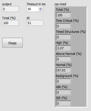

The problem I have is: it reports 100% cpu load and I don't get why it says so:
Where does this example VI burn 100% cpu load? Does the RTFIFORead just poll the current FIFO state?
