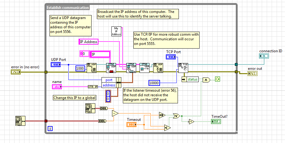

My program when executed starts by sitting in a state in which it sends out a UDP packet every 10 s to a specific IP looking for a response (the packet is sent, the UDP connection is closed and a TCP listener is opened on a specific port; see below).  If no timeout is specified, the port will be polled indefinitely.

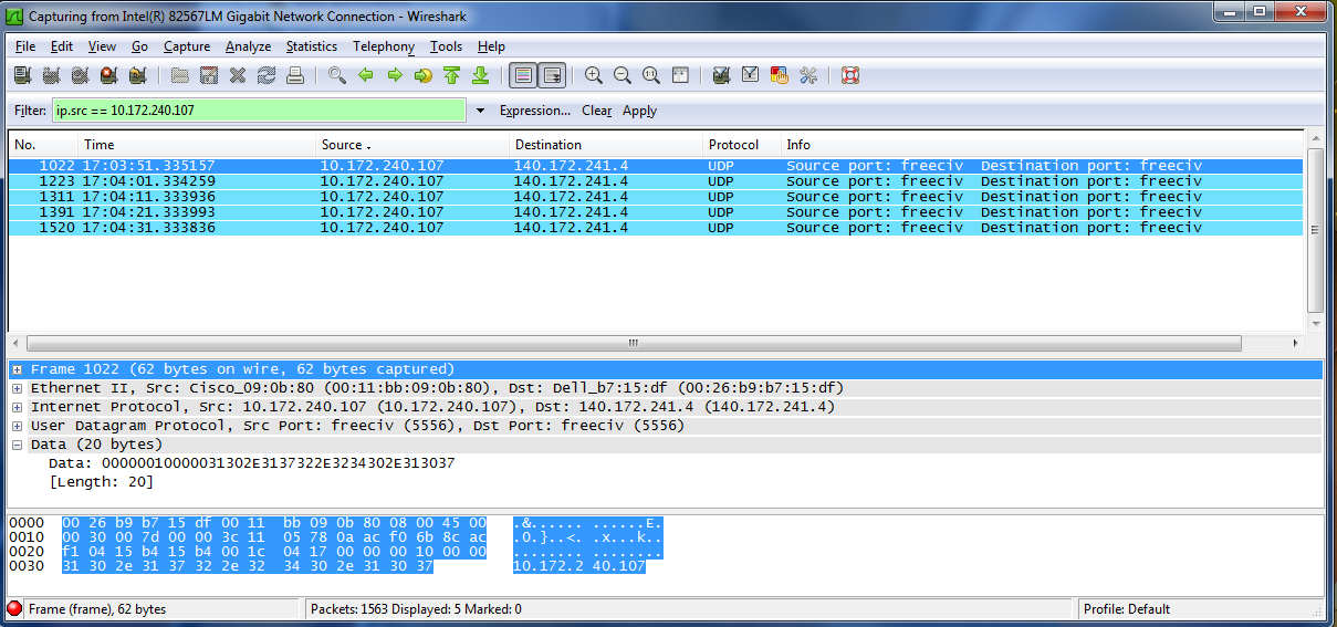

When the VI executes properly (and the executable has executed properly), I am able to see these packets coming across the network using a sniffer (Wireshark) (below).  When the VI does not execute properly, no packets are visible.  The VI executes properly if run from the VI itself every time.
18991iDB196B2589E50A25
 This issue only seems to pop-up when run off the executable.  I have even tried to run the above VI as the executable and I get the same behavior.  Does anyone have any thoughts as to why this might be occurring?

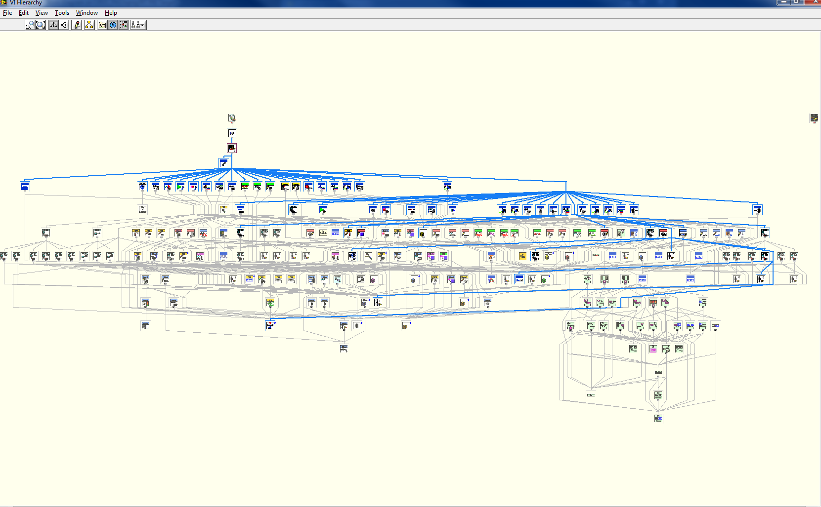

OK, so after a little more leg work, it appears that, when I debug the app on the chassis I get the warning that there is a series of "Unknown warning"s and they are all related to the DAQ dll nilvaiu.dll - "Error validating external library".  As it turns out, I can get the correct functionality of the VI above which pings for a connection; it is only when I attempt to run the app at large that I am getting a failure (sorry for the misleading entry above).  So, that being said - Marco, it is not feasible for me to provide the vi (see the hiearchy below to understand).  The architecture is highly LVOOP based and there are a lot of external libraries used (STM, OpenG, etc) as well as some config stuff that would have to be included for proper execution.
Does anyone understand why I might get this warning?  I don't understand what validating an external library is....
Peace Matt
19115i1B12CA1E7A6F89E4
