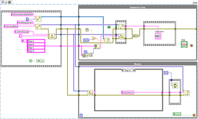

I've been using a sequencing framework based on the QMH architecture to drive various automated test setups (i.e. using control hardware). Among other things, the framework separates between the sequencing of test steps and the actual test logic and (theoretically) supports any number of sequencer instances sharing any number of test logic modules (or just modules).
In practice, both sequencers and modules are controlled by their respective message queues. I'm using a notifier to keep the sequencer from running away from the module, once the sequencer has sent the current test step to the module's queue, it waits on the particular module's notifier to be set, optonally containing test outcome data as well.
I cannot share the actual construct for various reasons, so I've cobbled together a functional analogue in this snippet, (yes I am aware that I'm not cleaning up the references as I should, the actual block diagrams do so):
Now, this has worked great, from operations where a single test cycle takes close to half a minute to applications where the same cycle is performed every 20ms. In some cases, the control program is distributed as a built executable, in other cases it runs in the development environment.
Now, various details of the implementation is constantly evolving and all of a sudden, I've had test units (running on built executables) get stuck in their sequence and I've figured out that I've fallen victim to a race condition I am unsure how to resolve. Additionally, it only seems to be a problem when using built executables, so far at least:
In some cases, for whatever reason, the module command sent down the module message queue is dequeued, goes through a pre-processing step, is performed, AND the HoldSequencer notifier is sent before the activity in the sequencer itself reaches the wait on notification function.

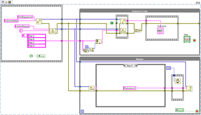

I've hoped placing the enqueue message and wait on notification blocks in a flat sequence frame would mitigate the issue (see snippet below), since that would at least allow the initial condition for both blocks to be fulfilled simultaneously. Thinking surely the program would not advance through the enqueue message block, do all the things in the module loop incl. setting the notifier before starting the wait on notification block, but to no avail.

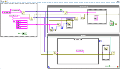

As a desperate, exploratory measure I've included a waiting function which puts a 10ms pause on the error wire leading into the enqueue message block. This does prevent the race condition from occurring, but would not be compatible with the application where the sequence command stack is executed every 20ms. Waiting 10ms for every step would defeat the purpose. Still, here's the analogue snippet.

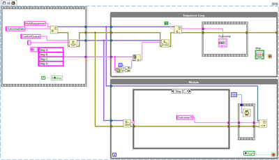

Now, on the current branch where I'm developing something, I've had to include an administrative notifier to be sent by the sequencer and it is the last thing the block diagram has to do before the error wire is split to its two receipients, but sending that notifier isn't "slow" enough to mitigate the issue. Further testing has shown that even a 1ms wait isn't enough. I've included the snippet for good measure as well.
