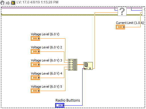

Hi all,
can someone edit my VI and tell me how to set the user defined Values to the DC power supply?
Also how can I set initial values?
For example when I start the VI that Button 1 is 1 V, Button 2 is 2 V etc.
No selection should disable the DC power supply.
Thanks!

i will check this today and reply if it worked,
thanks RavensFan
(2,367 Views)
Hi RavensFan,
it works. Thank you.
Just need to keep in mind that first array element is "No Selection".
