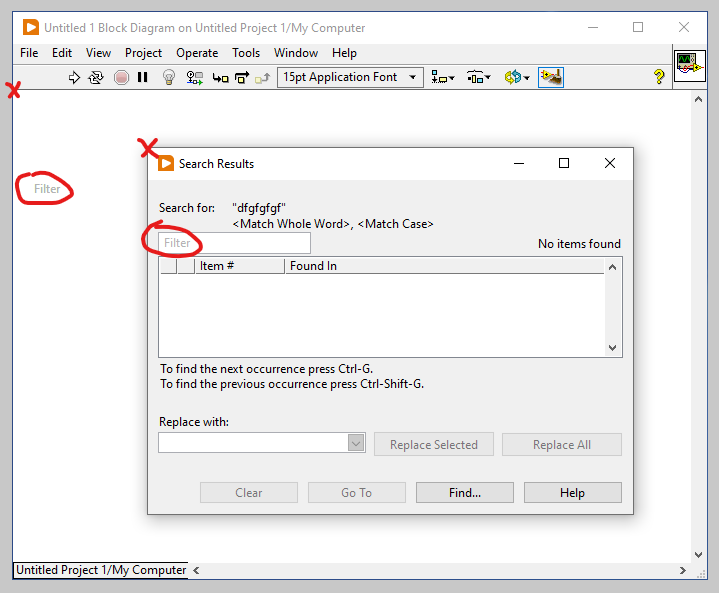

For years, I have notice a greyed-out "Filter" text string (or part of it) randomly appearing on my desktop, usually near the top left corner of the main monitor. Something like this...
This morning I was wondering what the other columns were in the LV search window (different topic...) when I noticed that if I enter some characters in the 'Filter' box and click away, the greyed out "Filter" comes back.
I believe artifacts of the greyed-out "Filter" are somehow being left behind.
I have no proof and have not been able to find a set of steps to reproduce the left-over "filter" text.... but I think I am a little closer to solving the mystery! 🔍
Tell me I am not crazy... you have noticed it too, right? RIGHT??

As far as I remember, I always had this visual glitch when using the search tool from a VI.
It appears after you complete a search, the "Filter" field content seems to get printed in the original VI.
To be able to see it, you need to reset your diagram to the origin (quickdrop ctrl+o).
The offset from the origin appears to be the same as in the Search Results dialog, as if the text was printed in the wrong VI.

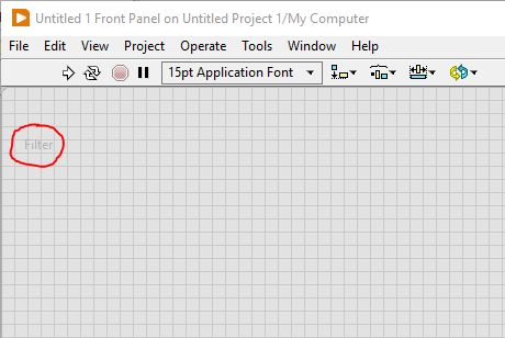

Depending on which VI side is on top, you can also have it on the front panel:
Maybe the text field is "insane" and deleting and recreating it in the tool could fix the issue...
