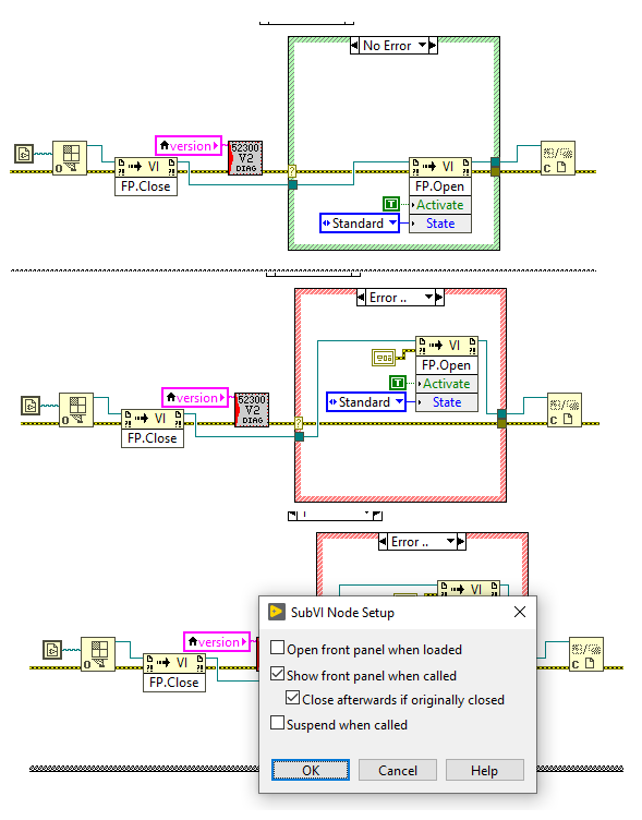

There is a "feature" of the LabVIEW executable that will cause it to close and be removed from memory when the last front panel is closed. Make sure the main front panel remains open while the password VI is executed!

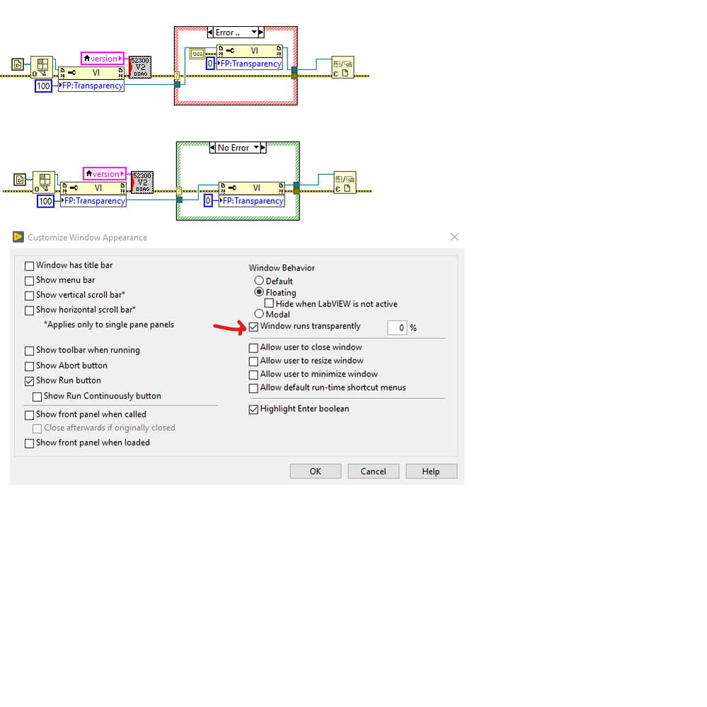

You make an excellent point. For the purpose of elegance, I like to close the front panel of a calling VI so that the called VI will be the only one present, otherwise I end up with a bunch of stacked front panels and it gets cluttered. I know that property nodes and invoke nodes do not work if there is an error entering the node, so I accommodate that by adding an unbound invoke node after the sub VI call. (see pictures). If there is an instance where I closed a front panel when I call a sub VI, then after the called VI closes naturally and the calling VIs front panel does not open, then there would be no active front panels and the program would just 'exit' without error. Is there a better way of closing front panels temporarily when a subVI is called and reopening them when the subVI exits?

I understand. It turns out setting the VI to hidden isn't available when the VI is active, but I can set Front Panel transperency to 100 when I call the subVI, and then set the calling VI transparency back to 0 after the subVI exists. I have to make sure the Window Appearance setting in the main VI for "Run VI transparently" is checked. This works and is a lot safer.
