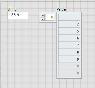

This might help you partially

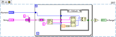

I would use hyphen then as it's just one less character. This is what I came up with, feels pretty clean I think. Don't think I inlined it yet.
Spoiler
Edit: Edge case if only one range (no comma). And you can replace the hyphen with something else to get negative number functionality, but Match Pattern doesn't like the double dot it seems.

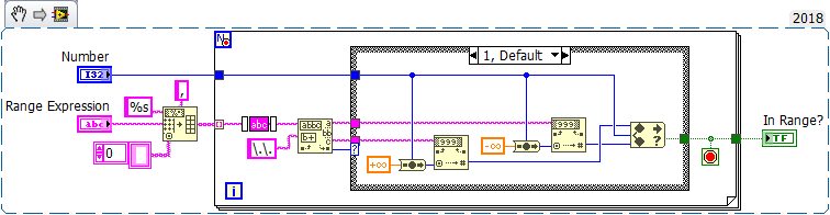

Nice.  Here's my variation of it (uses ".." instead of "-"; handles negative numbers; is malleable so it works with any numeric representation)
Oops, there's a bug: If you wire a numeric array to "Number", it doesn't work properly.
Since I don't need it to work on arrays, I'll put fixing it onto the back burner.
