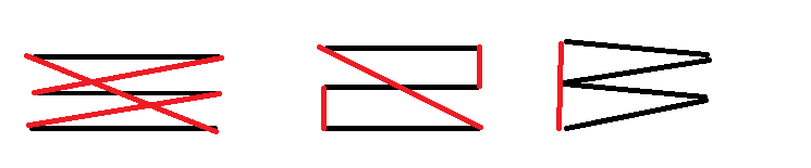

What does the angle equate to in terms of distance on the sample,or how far away are the galvos from the sample so we can work it out?
What actual raster pattern on the sample are you wanting to use (obviously there would be more scan lines, I just wanted to show the rough patterns). Is it one of these or something else?
Assuming black is acquiring moves and red is non-acquiring.
Will your camera always be free running or will you have some trigger/sync?
If you give more information, people will be able to help/advise you better. I feel like I am interrogating a mob boss here.
0xDEAD
Message 8 of 9
(4,578 Views)
     I cannot give a general angle- distance equivalency, as the distance between the sample and the galvo mirrors based on the imaging lens which I use. From the figures which you gave, the first one is the method which we are planning to use and the camera will not be free running, it will have a separate trigger so that we will be imaging only on requiring region.
