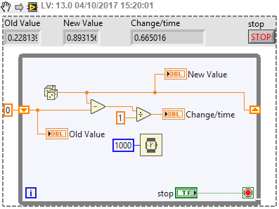

Sounds good so far. You have a well described algorithm (if not necessarily a very accurate one) and so now it just comes to programming it.
Have you managed to take a measurement yet? This will be the first/main step by the sounds of it - once you know how to make 1 measurement, it's just a matter of repeating and each time calculating differences. For that, it's likely easiest to use a Shift Register.
Example:

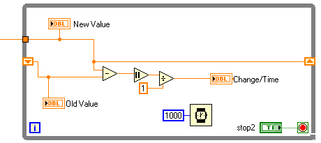

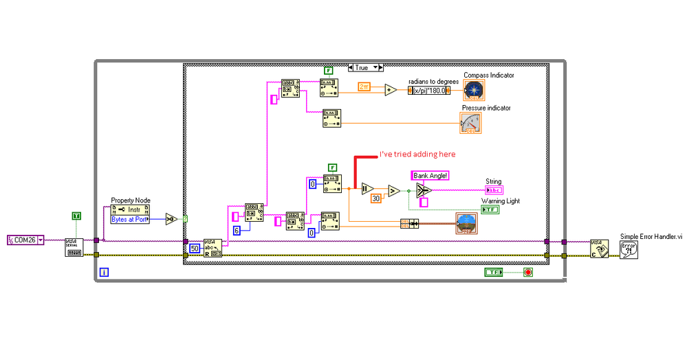

Thank for the reply.
I've tried putting the program you showed with my program and my program just do not work as before.
Is it because of the 2 while loop function at the same program?Not sure whats the issue
My programMy programThe shift registerThe shift register

My example was using the loop to generate subsequent samples - you should move the shift register onto the outer While loop and not add a second while loop at all. Then, it might work how you want it to.
I'm curious as to why you're using the Bytes at Port to trigger a read with no wait, especially given I'm thinking that 50 bytes combined with the True constant wired to the Configure Serial Port indicates it does use a termination character (and the lack of termination character specified suggests if I recall correctly a CR character (but it might be LF?)).

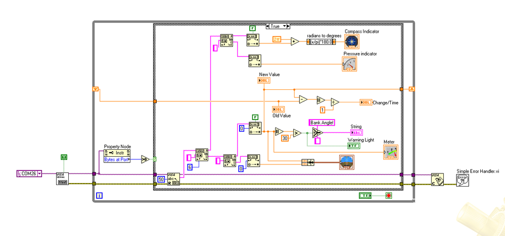

Apparently this work.But then i am pretty sure that the value i read at "Change/time indicator is not the the change/1sec.
Right now i am trying to find out how long does it take to travel from one shift register to another.(The difference in time for the "new value" and "old value"). So i can ÷ the value accordingly.
Note: I am unable to put the timer to 1000ms as it will cause lag to my rotation of compass etc.
Current testCurrent test
