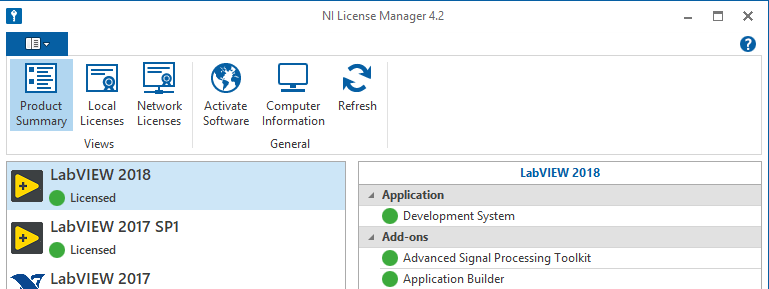

The license manager is a program found in the start menu. Look for "NI license manager".
Show us a screenshot after you run it if you still have questions.
Here's mine. (older version might look different, but they should have a way to select and activate.
