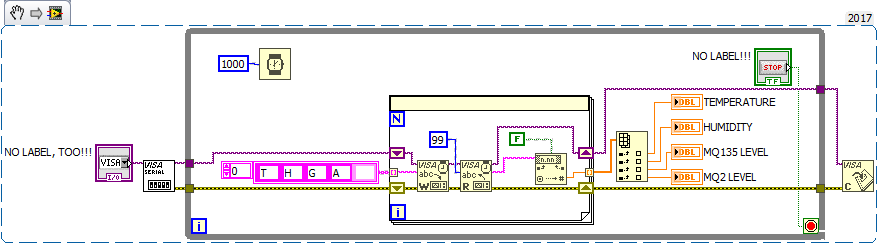

Hi marmaduke,
why don't you clean up your VI?
Then you would notice those 3 wait functions, which all wait for 1000ms in parallel.
Or you would notice you duplicated code 4 times just to read 4 values: use a loop to call the same code several times!
(One source of the problem might be the use of BytesAtPort: you are only reading messages partly. At 9600baud it takes ~10ms to transfer 10 chars, but you are checking the received bytecount each millisecond. Your VI works just how you have it programmed to work!)
The infos showed me are totally wrong ...
What is wrong? What is shown?
Can you attach any examples of what you expect to receive and what you receive instead from your device?
On your VI:
- DON'T USE BytesAtPort IN YOUR VI! Simple set VISARead to read 99 bytes, it will stop the reading at the TermChar you are using in both Arduino and LabVIEW code!
- Why are there so many control/indicators without a label? NEVER delete the label: you may hide it in the frontpanel…
What about this one?

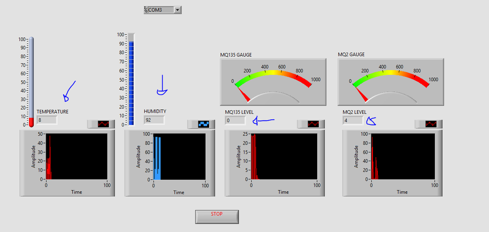

When i said the information were totally messed up, i meant the informations showed me (temperature, humidity, gases level...) were not working properly..
Labview was just showing 'anything'...

GerdW gave you a snippet.  Copy that image to your harddrive and drag it onto an empty diagram and you will have the code.  That snippet was made with LabVIEW 2017, so you will need a newer version to open it.
Message 4 of 24
(5,858 Views)
Hi marmaduke,
it's a snippet in my previous message…
Message 5 of 24
(5,857 Views)

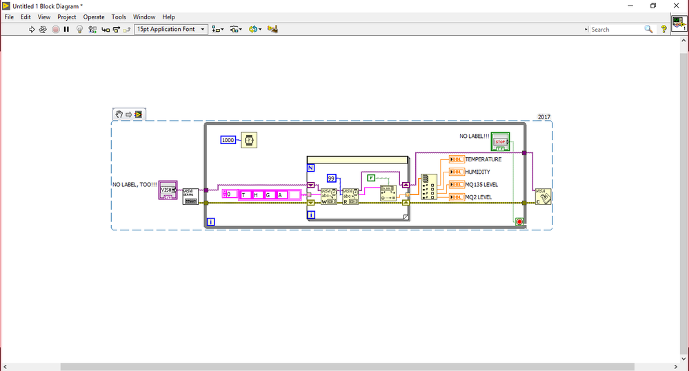

Like this?
Capturar.PNGSorry i have never heard before in this snippet
Message 6 of 24
(5,855 Views)
Hi Mamarduke,
did you follow my link into the LabVIEW help?
Anyway: which function don't you know? All I added was an IndexArray, all the rest is from your original VI…

I did it!
Now i'm going to test the code 😉
Thanks!
Message 8 of 24
(5,852 Views)

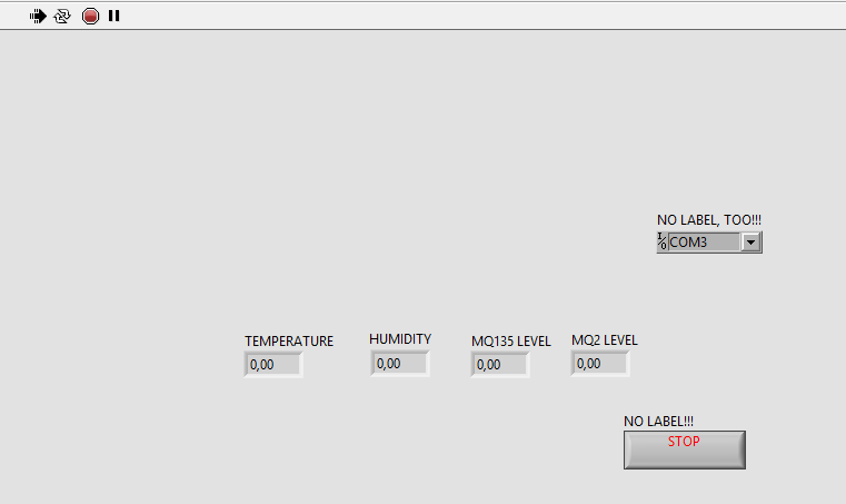

I opened you code in a new VI.
When i run the code i'm not receiving any info..

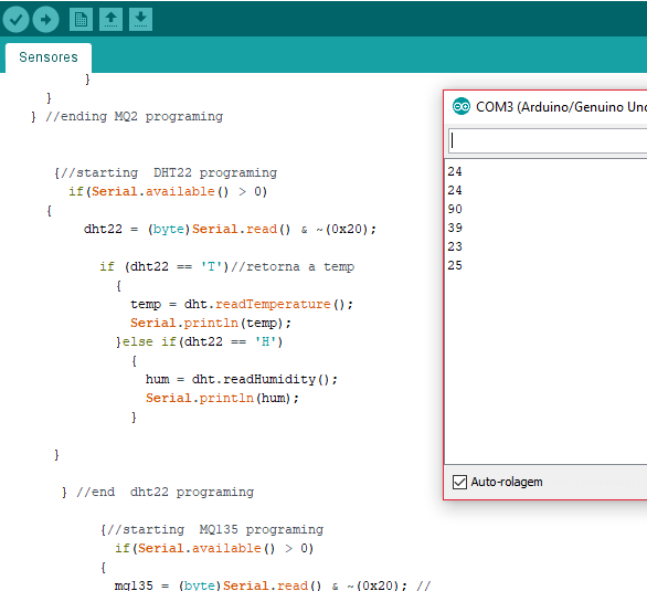

I tested in the serial monitor and i can call the informations:
Maybe there is something wrong in the C code?
I'm looking for some C code errors, but so far i got nothing.

I realized when I go to run the VI, the information appears very fast and it fades. I think it stays for 3 seconds and disappear.
I think there may be something wrong with the code, the only problem is that on the serial monitor I can see the information.
