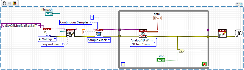

Start with one click
That will clean up about half of the dynamic data and DAQmx will automatically pull in the channel names.
Then look into Configure DAQmx LogginG
When your vi looks like this you'll be finished

Hi guys. I converted my VI as you suggested, but i have some questions:
1) i need the opportunity to see graphs and numerical indicators of the data that i'm recording (like the old VI that i posted)
2) if you look at the attached picture, i have the error 201309: how do i solve it?
Thank you all for the help !!!
