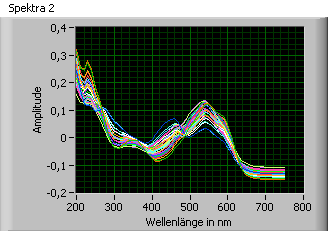

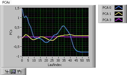

The input data is a 2d Array with 36 rows and 56 columns
Basically, a PCA algorithm decomposes this Array X into a structure part and
 a noise part.
Scores and loadings form the matrix product TP.
X = T1P1 + T2P2 + T3P3 + ... + Noise
If you just look at e.g. the first, second and third TP to define X there is less data to be taken into consideration:
The Output Array (without Noise) is a 2d Array with 3 rows and 56 columns
Those PCAs can be used to identify unlabeled data; one way of doing this would be regression as NaruF1 proposed.
