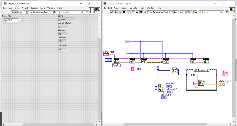

1) For reading the results from Adafruit INA 219 in Labview I make a program using the I2C library and Linx but I don't receive the correct values. I don't think that the program is good and I don't understand the I2C communication type. The datasheet of INA 219 is here: http://www.ti.com/lit/ds/symlink/ina219.pdf?ts=1590937044729 and my program here: https://imgur.com/nSi2IPr.Linx_I2C_WRONG.png

These are the results received by the current program and I don't understand the resultant string. The values are larger and without variations compared to the values provided by Arduino: 5...5.2 V, 5...5.2 V and 1.7...2.1 mA (for testing values 5V and 2A).

Quickest way forget LINX and just use the Arduino code you have and VISA to read the values sent from the Arduino
Here's a couple hints...
  1. Use PrintLn and send all of your data in one line separated by commas (34.4,45,34,)
  2. PrintLn adds a CR or LF to the end, use that as the "Termination Character" in VISA serial setup.
  3. Set VISA read to read more bytes than you expect to receive.
  4. VISA read will then wait until the termination or times out.
  5. Parse the received string using "spreadsheet string to array" and you will have a nice array of numeric values.
