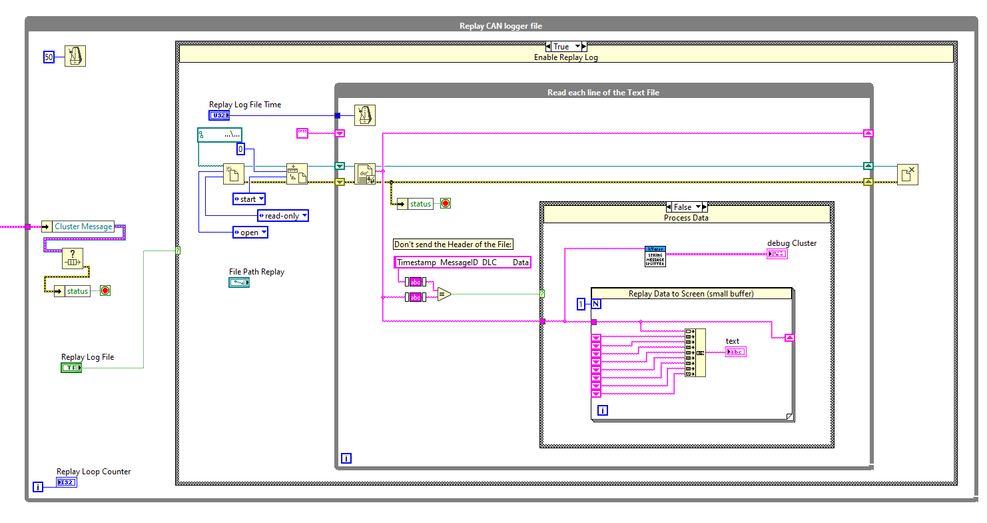

I have some parallels loop feed with a queue. I have a button to start reading a txt file and send it to some display.
The problem is that after some time I get the error:
"LabVIEW: (Hex 0x4) End of file encountered.
Invalid argument or arguments to function call."
I use the queue status to stop this loop. Any ideas on how to solve this issue?
Thank you

I have the main program that is reading some data from CAN.
I have a parallel loop that I can enable to store the data in a txt file.
However, I want to add a feature to use the same program to replay the data logged into the txt file. So i need to figure out to have no error when I get the EOL. Can I search if I am at the EOL and point again to the start of the txt file and make like a loop. The question is... When I close or stop the application, do I need to perform the Close file?

Hi PM,
You don't need to "figure out to have no error" - you need to "figure out how to handle that error"!
Suggestion:
IF error THEN SetFilePos(Start)
Looks rather simple: check for EOL error and set fileposition back to start…

Indeed...
I remove the Close Reference outside the loop that reads each line, and the program when i get the EOL starts reading again the file. With this i can handle it... and make some other changes.
Thank you for the help.
