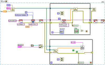

I would suggest you to use queue to write the data to a file as shown below. This gives an option for extending your current code and provide loss less and high speed data acquisition.

Here was one of the attempts it is similar to P Anand.
