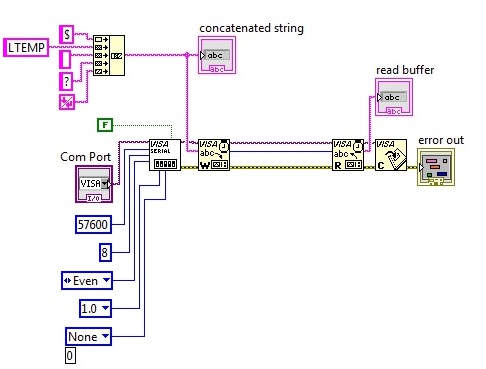

I have an instrument with message based communication. I prepared a simple VI to send command and read the response. (I disable the default termination character and appends EOL to the command format).  I prepared three versions:

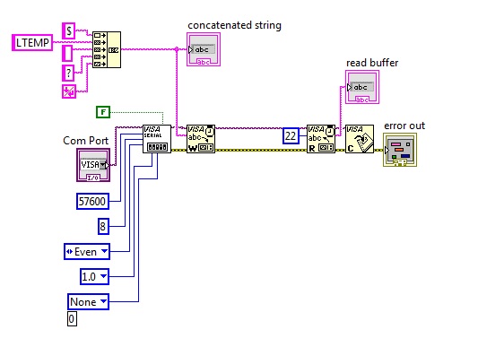

In the first I determine myself the expected bytes to read (in the attached image I read the temperature of the device).
This works and I get an answer quickly - but I want to process to be more general so it will suite for different number of byte for example - serial number readout.

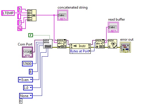

1.  Only disable the termination character if you don't expect to get back a termination character when you read a message.  Usually with text-based messages, you can expect a termination character.  With messages based on binary data, you don't get a termination character back because the character could either signal the end of the message, or be a perfectly valid byte inthe middle of the messages.  The enable/disable termination character on the serial configure has absolutely nothing to do with the tranmission of the termination character when you do a VISA write.  There is a property node that you can use to determine whether to send a termination character on a VISA write automatically, but generally there is no good reason to do that.  It is better programming practice to send the termination character yourself in the string you write to the VISA Write function.
2.  Reading up on the forums, you'll see this is just wrong.  You write and immediately check the bytes in the receive buffer.  Since you didn't really give the device time to get the message and turn around with a response, your bytes at port will very likely be zero, and almost certainly won't represent a complete response.
3.  This is completey wrong.  The number coming out of the VISA write is the number of bytes written.  Why do you think the number of bytes coming back in the response would be exactly equal to the number of bytes you wrote?  It is usually different, and even if it is the same, it is usually just a coincidence.
The best way to figure out how to make your serial communications work is to start reading the instruction manual that comes with the device and pay attention to serial port settings (baud, parity, stop bits, data bits) and the structure of the commands that you send to it and the responses you should receive from it.  Only when you read and understand that will you figure out the appropriate way to program your LabVIEW application.

In the bottom code, you are requesting to read exactly as many bytes as you write. Is that actually what you want to do? What is your question?

I'm not sure I follow you on the main issue - point (2)  - as you can see from my attaced images, I did set baud rate, parity and others... my first image when I read with expectation of constant byte number (22) is working! and as you can see I don't do any delay between the write and the read in this case. so It doesn't seem likely to be timing issue.
this will work for one command who return 22 bytes, and by changing the constant I can read other command which returns different number of bytes.
but how do I set it to read all the bytes on the port - I don't want to use constants?

It works because VISA has a built-in timeout, so what's happening here is that you are waiting for either 22 bytes or for the timeout to occur, whichever happens first.
If your device does send a termination character, then using it is the easiest solution - the read is ended by a termination character, regardless of how many bytes were received (if no termination character, then it still waits for a timeout). Or you can do it with the "bytes at port" like your second image, but in that case you should insert a short wait between the write and checking for bytes at port, to allow time for device to process the command and send the response.

1.  If you do not use a termination character, then you use a wait function to give your device a sufficient amount of time to return what you expect to be a full message.  Then do the bytes at port method and read that many bytes.
