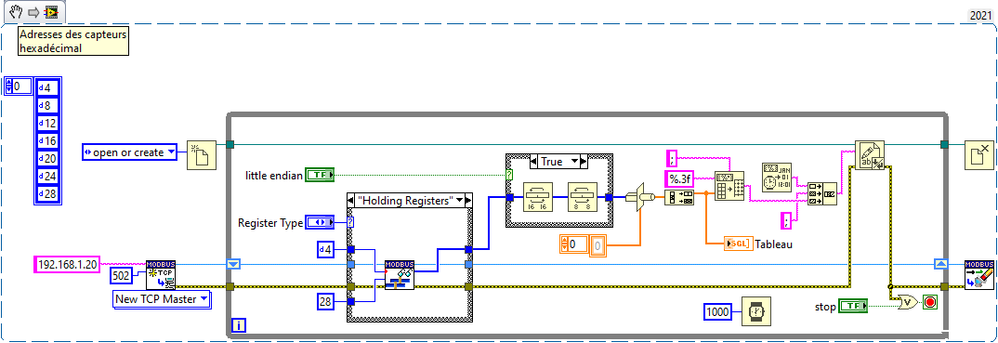

You need to replace read-register(sous-VI).vi with one of these and read multiple registers at once:
Then, convert your data and keep the stuff that you are interested in, ending up with something like this:
reading multiple modbus registers and converting to floatreading multiple modbus registers and converting to float
(557 Views)

Hi, Thanks a lot for your time. The last VI works well, I did some minor adjustment and I understand better how it's working.
Regards
Adrien
