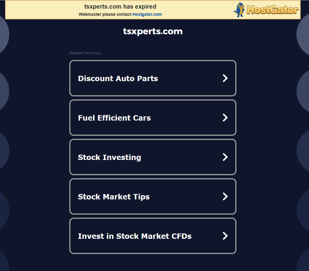

Looks like TSXperts is totally dead now.
(1,218 Views)
You can still get it from NI Arduino™-Compatible Compiler for LabVIEW
