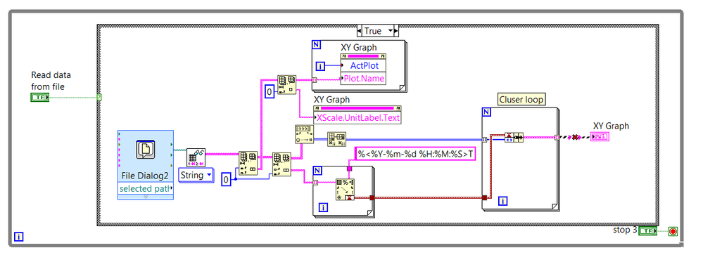

I save data in a file. After that, I want to read the file in a different place and plot it in a graph.
As you can see in the file "values", the 1st row is names and the collumns are the values that belong to them. (there are many more, about 120 columns)
  • I've taken the first row, used a property node and used it to add the names to the correct plots.
  • I can get all the values in the graph correct.
  • What I can't seem to figure out though, is how to take the first column (originally a timestamp, now a string) and use it to make a correct x-axis.
So, the problem is theoretically very easy, but I just can't get it to work! Can anybody help me?
I have LabVIEW 2017, 32-bit.

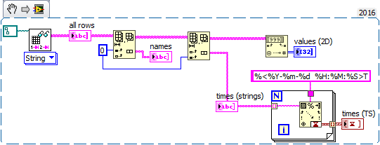

parse time from stringparse time from string
(3,610 Views)
Thank you so much! That solution is much simpler than mine!

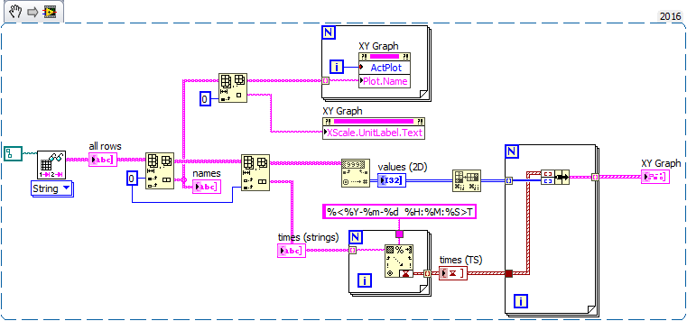

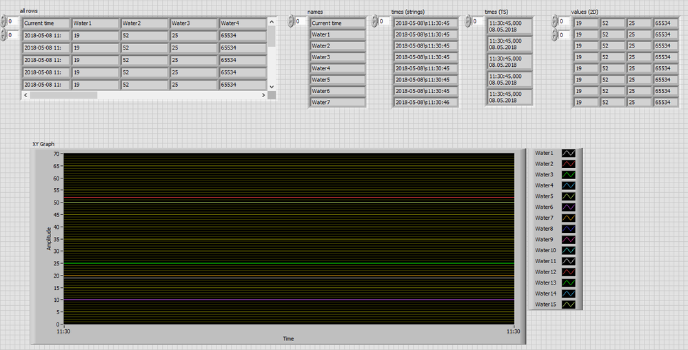

Do you think you can help me with the end too? The timestamp and the Y-values in a graph.
I've been trying with a waveform graph and a "build waveform", but can't get it to work since the Y only wants 1D arrays. I also tried with an XY graph, but couldn't get it to work eather.
(3,585 Views)
Accepted by topic author elicom

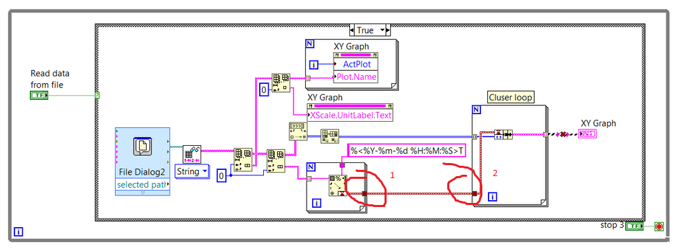

I think however that there might be a difference between 2016 and 2017 LabView. I did exactly as you did, but I get a broken wire. In my "Cluster loop", the time stamp still has the timeglas and yours doesn't have that. Do you know why?read data.PNG
elicom
(3,557 Views)
You should enable auto indexing at point 1 and leave it disabled at point 2
(3,551 Views)
Thank you!
I saw that literally 2 mins before your post! 🙂 Thanks a million!
